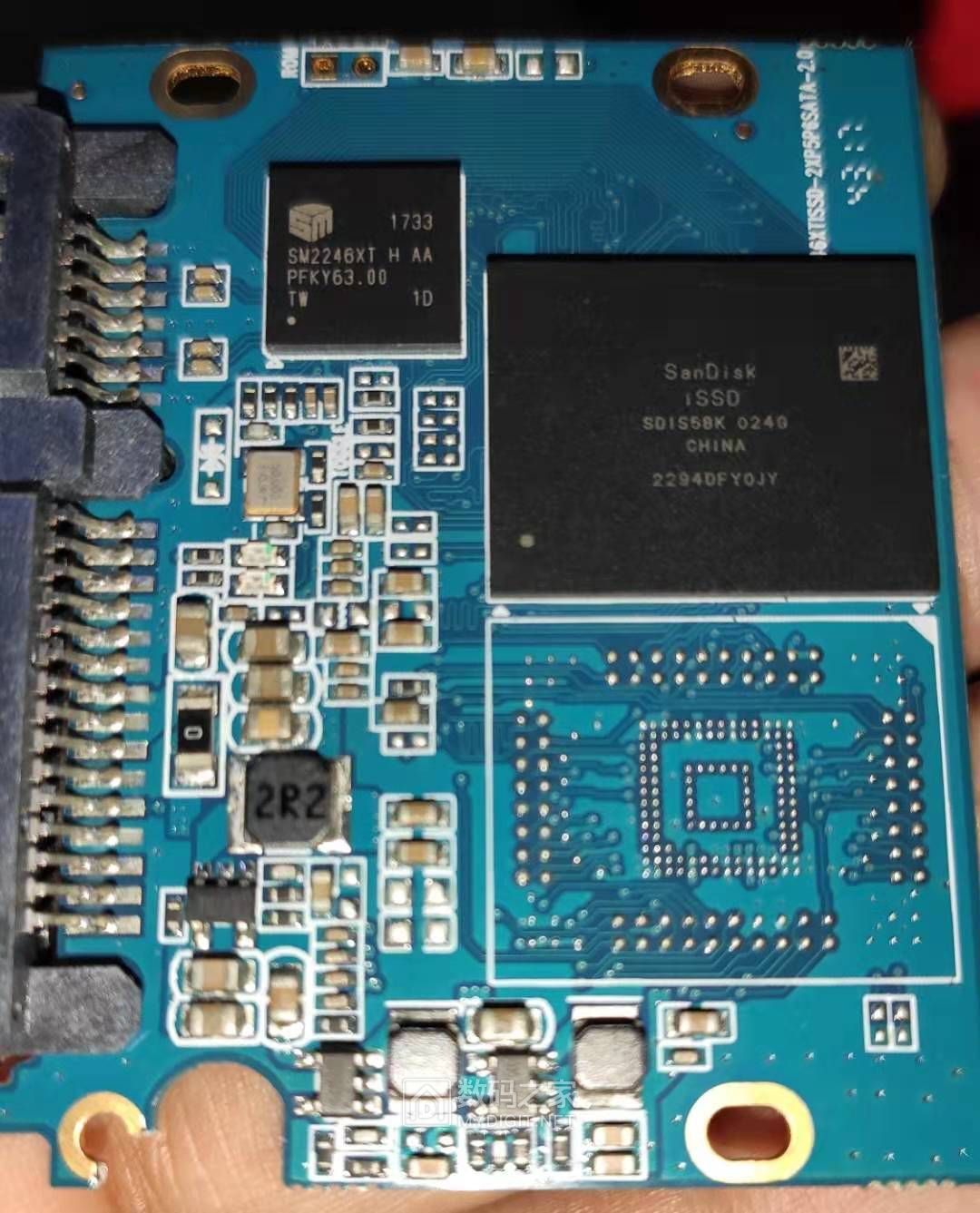

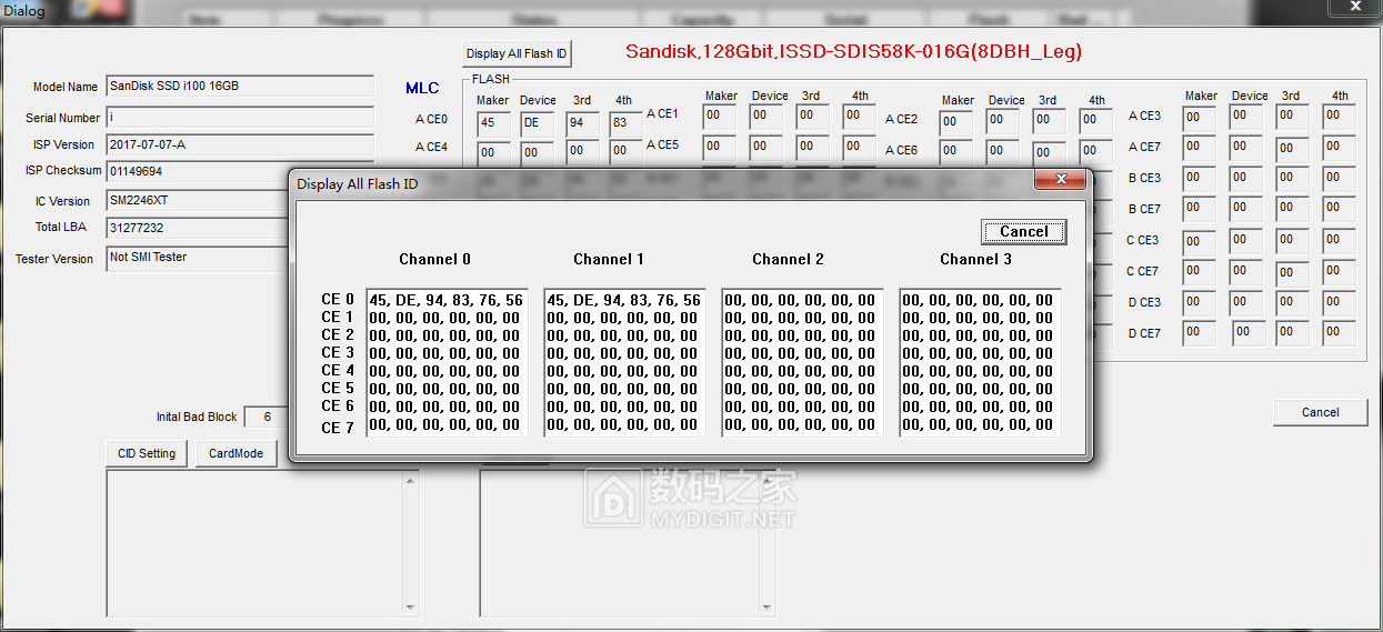

哪位大神赏赐一个46XT开45,DE,94,83,76,56的开卡参数
46XT参数文件里面没有,只有在46en的参数里找到两个类似的,有没有大神会改参数啊。
A322=SanDisk,256Gbit(16K),SDZNPQCHER-32GT
SanDisk,256Gbit(16K),SDZNPQCHER-32GT=45,DE,94,83,76,D6,2,08,10,0,3933,4096,8,3,0,128,2,16,1280,3,28,8F,27,30,1,1F,3,0,1,2,1,52,51,0,0,0,1,0,0,80,77,77,77,77,12,18,55,55,44,44,44,44,0,0,〗,,
A65=Toshiba,128Gbit(16K),TH58TEG7DBHBAMC
Toshiba,128Gbit(16K),TH58TEG7DBHBAMC=98,DE,94,83,76,D6,2,08,10,0,4036,4096,2,9,1,128,2,16,1280,3,68,8F,27,30,1,5F,2,1,1,2,1,52,51,0,A2,0,1,0,0,C0,88,88,88,88,12,26,88,88,66,66,66,66,0,0,〗,,

你这颗粒应该是对应东芝24纳米mlc,慢慢试慢慢套啊
