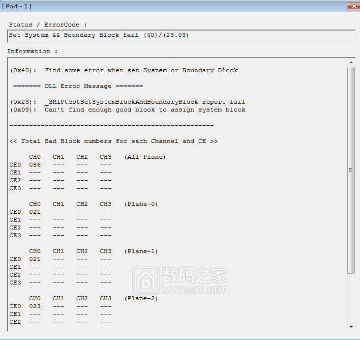

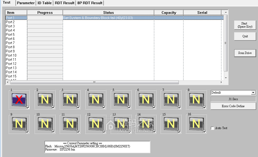

如图所示,显示坏块是不多的,但是出现了这个错误Set System && Boundary Block fail (40)/(23.03)
(0x40):  Find some error when set System or Boundary Block
======= DLL Error Message =======
(0x23):  _SMIPtestSetSystemBlockAndBoundaryBlock report fail
(0x03):  Can't find enough good block to assign system block
<< Total Bad Block numbers for each Channel and CE >>
     CH0   CH1   CH2   CH3   (All-Plane)
CE0  086   ---   ---   ---
CE1  ---   ---   ---   ---
CE2  ---   ---   ---   ---
CE3  ---   ---   ---   ---
     CH0   CH1   CH2   CH3   (Plane-0)
CE0  021   ---   ---   ---
CE1  ---   ---   ---   ---
CE2  ---   ---   ---   ---
CE3  ---   ---   ---   ---
     CH0   CH1   CH2   CH3   (Plane-1)
CE0  021   ---   ---   ---
CE1  ---   ---   ---   ---
CE2  ---   ---   ---   ---
CE3  ---   ---   ---   ---
     CH0   CH1   CH2   CH3   (Plane-2)
CE0  023   ---   ---   ---
CE1  ---   ---   ---   ---
CE2  ---   ---   ---   ---
CE3  ---   ---   ---   ---
     CH0   CH1   CH2   CH3   (Plane-3)
CE0  021   ---   ---   ---
CE1  ---   ---   ---   ---
CE2  ---   ---   ---   ---
CE3  ---   ---   ---   ---
这个还有救吗

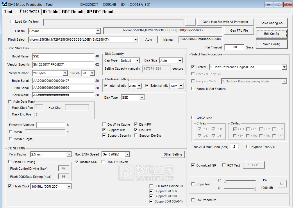

发表于 2019-10-8 10:05:08 | 显示全部楼层
设置图发上来看看?Q.erase点选了没?
 楼主| 发表于 2019-10-9 21:36:59 | 显示全部楼层
没找到你说的Q erase啊,在那一页啊
发表于 2019-10-10 21:20:41 | 显示全部楼层
这种情况根据经验一般都是坏块太多了
发表于 2019-10-11 09:36:13 | 显示全部楼层
如楼上所说,可能是坏块太多,降容开试试。
发表于 2020-9-9 15:47:04 | 显示全部楼层
试一下勾选force im set feature
发表于 2021-1-29 16:16:47 | 显示全部楼层
我有一个盘是一样的故障 坏块也不多 勾选这个开卡成功了 想问下这个选项是啥意思呢:lol:
回复 支持 0 反对 1
发表于 2021-1-29 18:07:02 | 显示全部楼层
这种情况直接指定容量下或者降低下容量/应该是颗粒的坏块有点多需要清空一下/颗粒频率降低到100MHZ/force im set feature这意思就是强制忽略某些特征
发表于 2022-10-19 22:05:07 | 显示全部楼层
force im set feature在什么地方
