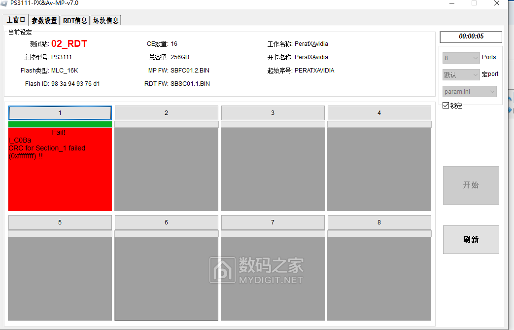

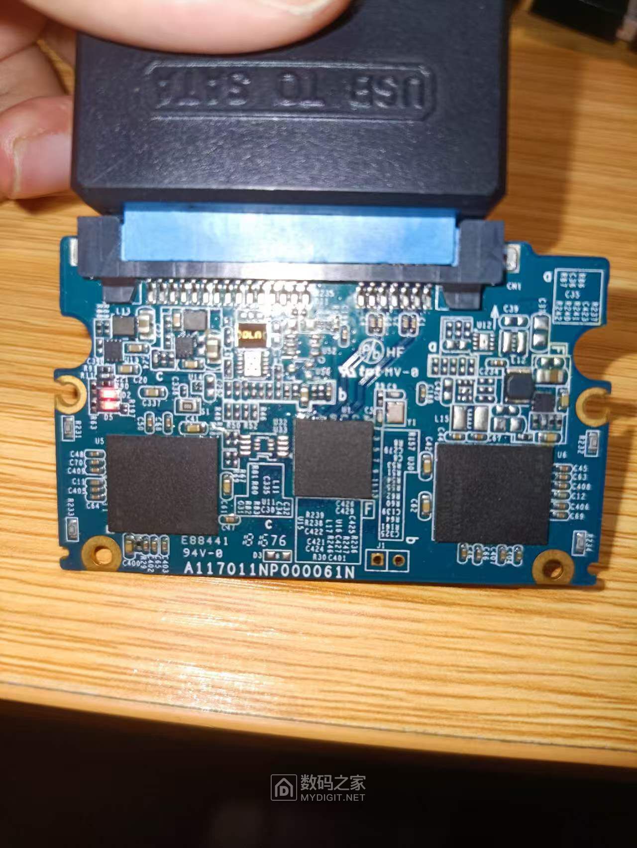

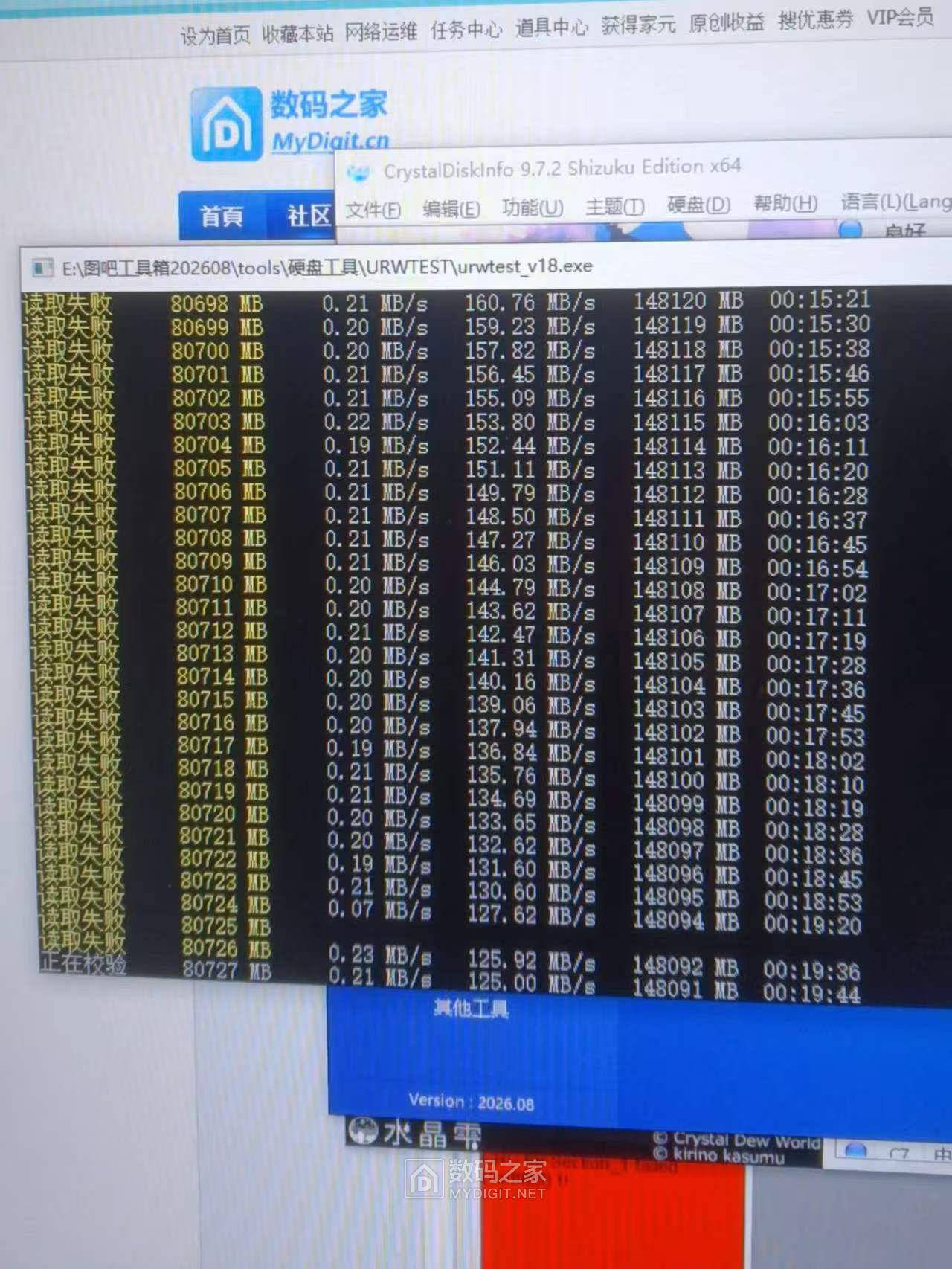

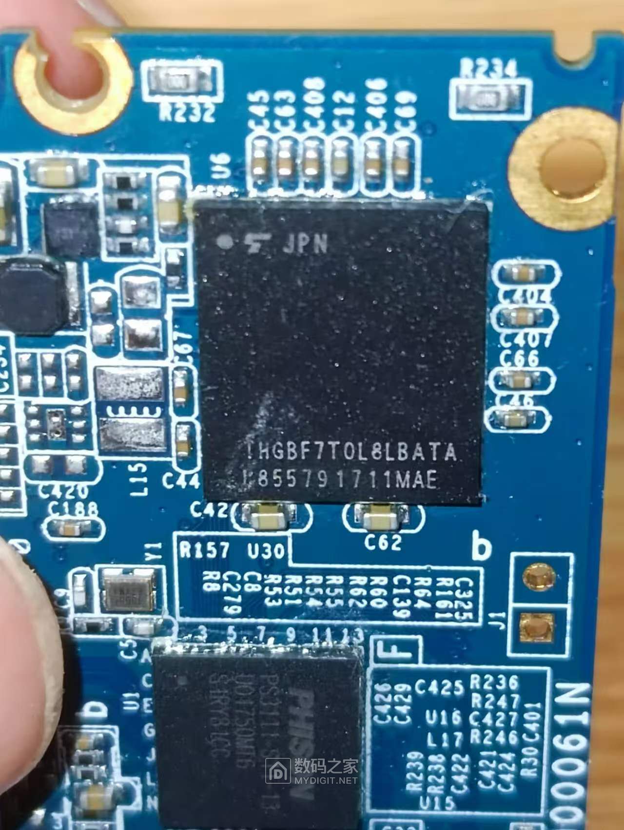

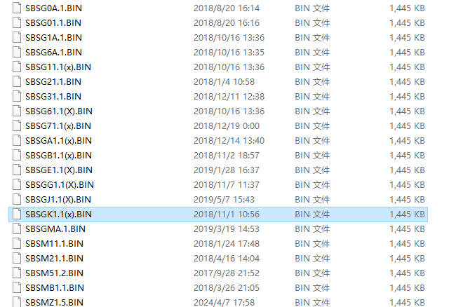

求助一下ps3111-11怎么跑rdt诊断,这块板子是影驰的铁甲战将240,但是根据论坛里另外一个大哥的金百达kp版号是一摸一样的,所以用了他的方法成功开卡,但是跑诊断坏的特别多,想跑因此rdt,但是论坛里找不到相应的教程
3111SBISP_CodeVersion=GK1.1
3111SBISP_MPBINCode=.\Bin\SBSGK1.1.BIN
3111SBISP_RDTBINCode=.\Bin\SBSC01.1.BIN
SSD Size=2.5"
[Options]
DDRSize=32
Set Firmware Name=SBSG11.1
Do_BurnIn_PreTest=1
ECC threshold=50
SLC ECC threshold=20
Enable_ECCthreshold_MarkBad=1
RDTLED_State=0
Use Partial Size=1
Put_Thermal_Sensor=0
Skip_Check_RDDebugPage=1
PretestType=1
PMASetting=42035
Do_Hard_Bit_Retry_Test=1
[RDT]
Do_RDT=1
Enable_Set_Cycle=1
Cycle=1
Enable_Set_Cycle_SLC=1
Cycle_SLC=1
ReadRetrySel=1
Byte_189=0
[InfoBlock]
Byte_290=E8
Byte_291=03
[EraseAll]
Do_Erase_First=1
Type=09
   [Log]
   Use Partial Size, 256 GB -> 240 GB.
[ Success ] Modify InfoBlock OK.
[ Success ] AES VUC Process OK.
   [ Info ] MP AP: V2.06_x02(China), MAC Address: , ISP FW: SBSGK1.1.BIN, Station:F1P
[ Success ] Check Device State OK.
[ Success ] Check IO State OK- Total take 0.051 sec.
[ Success ] Delete Layout...
[ Success ] Delete Layout Succeed!
[ Success ] Check ICVer. OK.
[ Success ] Verify param.ini with Device Info OK.
   Ori Device Use Partial Size.
[ Success ] Check Device Full/Partial Size OK.
   StandBy.
   Jump ok.
[ Success ] Force To Boot Code OK.
[ Fail ]  Error Message : CRC for Section_1 failed (0xffffffff) !!
             Error Code : I_C0Ba
             AP Command : [a1]-[8]-[e]-[30]-[1]-[0]-[0]-[0]-[a0]-[21]-[0]-[0]
             OS LastError : [ 0 ]
             ATA Reg:[0][1][0][0][0][50]
[ Error End ] Time: (18:24:28)

sg的rdt固件打x的是尝试过的
sg的rdt固件打x的是尝试过的
