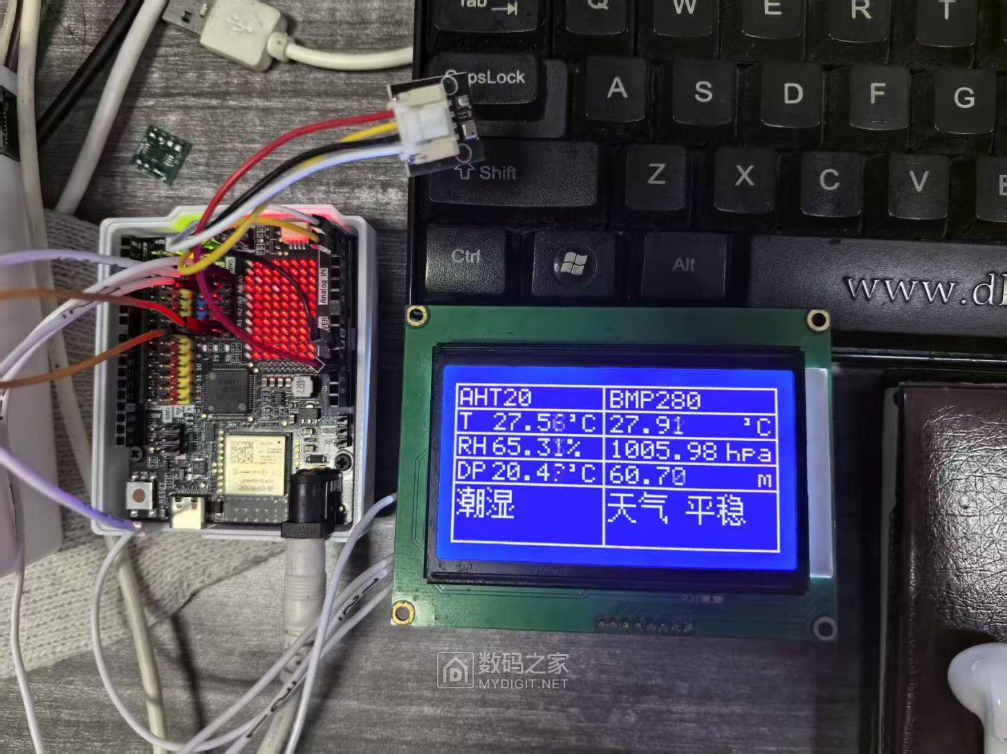

[Arduino] AHT20+BMP280制作温湿度气压+天气预报12864点阵显示
发表于 2026-4-21 11:48:21 | 显示全部楼层 |阅读模式
需要在arduino ide-管理库-自己安装一下对应的库,LCD用的是瑞立德12864 i2c接口,程序基本上兼容大部分arduino比如uno r3 r4 due
LCD库是我自己修改过的,厂家提供那个没有直接使用wire库,导致多个i2c使用有问题,而且不能用在avr以外的mcu

  char f1[]={0XBC,0XB4,0XBD,0XAB,0X20,0XCF,0XC2,0XD3,0XEA,0,};//即将 下雨
  char f2[]={0XBC,0XB4,0XBD,0XAB,0X20,0XCF,0XC2,0XD3,0XEA,0,};//即将 晴天
  char f3[]={0XD7,0XAA,0XD2,0XF5,0X20,0XCF,0XC2,0XD3,0XEA,0,};//转阴 下雨
  char f4[]={0XCC,0XEC,0XC6,0XF8,0X20,0XBA,0XC3,0XD7,0XAA,0,};//天气 好转
  char f5[]={0XCC,0XEC,0XC6,0XF8,0X20,0XC6,0XBD,0XCE,0XC8,0,};//天气 平稳
    char f6[]={0XB8,0XC9,0XD4,0XEF,0,};//干燥
    char f7[]={0XC6,0XAB,0XB8,0XC9,0,};//偏干
    char f8[]={0XCA,0XE6,0XCA,0XCA,0,};//舒适
    char f9[]={0XC2,0XD4,0XCA,0XAA,0,};//略湿
    char f10[]={0XB3,0XB1,0XCA,0XAA,0,};//潮湿
    char f11[]={0XC3,0XC6,0XC8,0XC8,0,};//闷热
    char f12[]={0XB5,0XE7,0XB3,0XD8,0XB5,0XE7,0XC1,0XBF,0XB2,0XE2,0XC1,0XBF,0,};//电池电量测量
    char f13[]={0XC7,0XEB,0XC1,0XAC,0XBD,0XD3,0XB5,0XE7,0XB3,0XD8,0,};//请链接电池
    char f14[]={0XB2,0XE2,0XC1,0XBF,0X20,0X20,0XCD,0XEA,0XB3,0XC9,0,};//测量 完成

void lcd(){
  //int br=map(analogRead(A0),0,4095,0,255);
    RSCG12864B.brightness(255); // 设置中等亮度
char str1[20];char str2[20];char str3[20];char str4[20];
char str5[20];char str6[20];
  sprintf(str1, "%3.2f", currentTemperature);  // 调整为8宽度
  sprintf(str2, "%3.2f", currentHumidity);  // 调整为8宽度
  sprintf(str3, "%4.2f", temp_bmp);  // 调整为8宽度
  sprintf(str4, "%4.2f", pressure);  // 调整为8宽度
  sprintf(str5, "%4.2f", altitude);  // 调整为8宽度
  sprintf(str6, "%4.2f", dewPoint);  // 调整为8宽度
  RSCG12864B.print_string_5x7_xy(2,2,"AHT20");
  RSCG12864B.print_string_5x7_xy(2,12,"T");
  RSCG12864B.print_string_5x7_xy(2,22,"RH");
  RSCG12864B.print_string_5x7_xy(46,12,"'C");
  RSCG12864B.print_string_5x7_xy(46,22,"%");
  RSCG12864B.print_string_5x7_xy(2,32,"DP");
  RSCG12864B.print_string_5x7_xy(46,32,"'C");
  RSCG12864B.print_string_5x7_xy(63,2,"BMP280");
  RSCG12864B.print_string_5x7_xy(114,12,"'C");
  RSCG12864B.print_string_5x7_xy(108,22,"hpa");
  RSCG12864B.print_string_5x7_xy(120,32,"m");
  RSCG12864B.draw_line(60, 0, 60, 62);     // 垂直线
  RSCG12864B.draw_line(0, 10, 127, 10);     // 横线
  RSCG12864B.draw_line(0, 20, 127, 20);     // 横线
  RSCG12864B.draw_line(0, 30, 127, 30);     // 横线
  RSCG12864B.draw_line(0, 40, 127, 40);     // 横线
  RSCG12864B.draw_rectangle(0, 0, 127, 63);//矩形 边框
  RSCG12864B.print_string_5x7_xy(16,12,str1);
  RSCG12864B.print_string_5x7_xy(16,22,str2);
  RSCG12864B.print_string_5x7_xy(63,12,str3);
  RSCG12864B.print_string_5x7_xy(63,22,str4);
  RSCG12864B.print_string_5x7_xy(16,32,str6);
  RSCG12864B.print_string_5x7_xy(63,32,str5);
