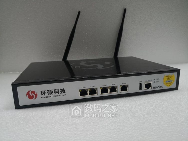

马家买了无线路由器,配置蛮高,1.2g cpu,512m 内存,运行openwrt,卖家说有些问题,没在意以为改下通信规则就可以自己搞定,结果翻车。 1.jpg 2.jpg
连上串口,信息如下:

** MARVELL BOARD: RD-88F6281A LE
U-Boot 1.1.4 (Aug  6 2014 - 16:49:28) Marvell version: 3.5.9 - v16288q
U-Boot code: 00600000 -> 0067FFF0  BSS: -> 006D1340
Soc: 88F6281 A1
CPU running @ 1200Mhz L2 running @ 400Mhz
SysClock = 400Mhz , TClock = 200Mhz
DRAM (DDR2) CAS Latency = 5 tRP = 5 tRAS = 18 tRCD=6
DRAM CS[0] base 0x00000000   size 256MB
DRAM CS[1] base 0x10000000   size 256MB
DRAM Total size 512MB  16bit width
Addresses 8M - 0M are saved for the U-Boot usage.
Mem malloc Initialization (8M - 7M): Done
NAND:512 MB
Flash:  0 kB
CPU : Marvell Feroceon (Rev 1)
Streaming disabled
Write allocate disabled
Module 0 is RGMII
Module 1 is TDM
USB 0: host mode
PEX 0: PCI Express Root Complex Interface
PEX interface detected Link X1
Net:   egiga0, egiga1 [PRIME]
Hit "F2" key to stop autoboot:  0
NAND read: device 0 offset 0x100000, size 0x300000
3145728 bytes read: OK
## Booting image at 02000000 ...
   Image Name:   Linux-3.3.8
   Created:      2014-11-05   9:19:12 UTC
   Image Type:   ARM Linux Kernel Image (uncompressed)
   Data Size:    1130456 Bytes =  1.1 MB
   Load Address: 00008000
   Entry Point:  00008000
   Verifying Checksum ... OK
OK
Starting kernel ...
Uncompressing Linux... done, booting the kernel.
[    0.000000] Booting Linux on physical CPU 0
[    0.000000] Linux version 3.3.8 (zhangbin@ubuntu) (gcc version 4.6.3 20120201 (prerelease) (Linaro GCC 4.6-2012.02) ) #3 Wed Nov 5 01:19:07 PST 2014
[    0.000000] CPU: Feroceon 88FR131 [56251311] revision 1 (ARMv5TE), cr=00053977
[    0.000000] CPU: VIVT data cache, VIVT instruction cache
[    0.000000] Machine: Prafly M8621T Router Board

[   12.711615] NAND device: Manufacturer ID: 0xec, Chip ID: 0xdc (Samsung NAND 512MiB 3,3V 8-bit)
[   12.720296] Scanning device for bad blocks
[   12.735999] Bad eraseblock 212 at 0x000001a80000
[   12.772257] Bad eraseblock 792 at 0x000006300000
[   12.830049] Bad eraseblock 1767 at 0x00000dce0000
[   12.905066] Bad eraseblock 3056 at 0x000017e00000
[   12.911900] Bad eraseblock 3095 at 0x0000182e0000
[   12.967218] Bad eraseblock 4023 at 0x00001f6e0000
[   12.976111] Creating 5 MTD partitions on "orion_nand":
[   12.981290] 0x000000000000-0x000000100000 : "u-boot"
[   12.987155] 0x000000100000-0x000000300000 : "kernel"
[   12.992999] 0x000000300000-0x000002000000 : "rootfs"
[   12.998831] mtd: partition "rootfs" set to be root filesystem
[   13.004676] mtd: partition "rootfs_data" created automatically, ofs=680000, len=1980000
[   13.012815] 0x000000680000-0x000002000000 : "rootfs_data"
[   13.019024] 0x000000100000-0x000002000000 : "firmware"
[   13.025012] 0x000002000000-0x000020000000 : "usrdata"

[   13.442053] VFS: Mounted root (squashfs filesystem) readonly on device 31:2.
[   13.449507] Freeing init memory: 128K
- preinit -
Press the [f] key and hit [enter] to enter failsafe mode
- regular preinit -
[   17.775243] JFFS2 notice: (1452) jffs2_build_xattr_subsystem: complete building xattr subsystem, 3 of xdatum (0 unchecked, 3 orphan) and 30 of xref (0 dead, 30 orphan) found.
switching to jffs2
- init -
Please press Enter to activate this console. [   18.525663] Loading modules backported from Linux version master-2013-06-27-0-gdcfa6d5
[   18.533641] Backport generated by backports.git backports-20130617-4-ge3220f5

自己折腾的过程:
1.wan口动态ip,lan口dhcp可以ping通路由器自己,也可ping通wan,还可以ping通www.baidu.com
2.在串口能get到www.baidu.com的网页,lan口就是不能访问互联网,ip地址也不行。
3.偶尔跳出Portal认证(WEB认证)才发现,这个路由使用了认证,现在情况是这家路由公司已经倒闭,网址也不可用,所有不能上网。
4.串口进去想干掉认证功能块,结果opkg原厂固件已精简,现在我自己搞不定编译,这是个死胡同。
5.进去想看看能否修改认证模块文件,也不知怎么下手。
望高手指点。
